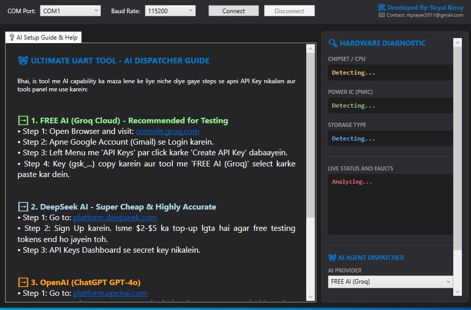

I'm happy to release Ultimate UART Tool, a 100% FREE, standalone, and offline utility developed for the global smartphone repair community. It helps technicians analyze real-time UART boot logs from Android devices and quickly identify hardware-related issues.
No activation required.
No server credits.
No subscriptions.
Completely free forever.
🔍 Features
✅ Dynamic Chipset Detection
Automatically detects supported platforms as soon as the boot log begins.
Supports MediaTek Preloader and Unisoc/Spreadtrum (SharkL series) devices.
✅ Offline Hardware Inspector
Detects and displays:
CPU Information
PMIC IDs
eMMC/UFS Storage Status
RAM Initialization
Boot Stages
✅ Smart Bootloop Detection
Automatically detects repetitive preloader boot loops.
Freezes the log to prevent endless scrolling and makes analysis easier.
✅ Integrated AI Analysis
Supports external AI services such as:
Groq Cloud (Llama 3)
DeepSeek
OpenAI API
The AI translates cryptic boot errors, kernel panics, and miscdata issues into easy-to-understand hardware troubleshooting steps in English or Hindi.
✅ Built-in Help Center
API registration guide
Setup instructions
Usage documentation

💻 Quick Start
Connect your UART interface (CP2102 / FTDI / UniBox).
Install the proper USB Serial drivers.
Open UltimateUARTTool.exe.
Select the correct COM Port.
Choose 115200 Baud (recommended for most MTK/Unisoc preloaders).
Click Connect.
Power on the phone or trigger boot mode.
Live UART logs will begin streaming automatically.
